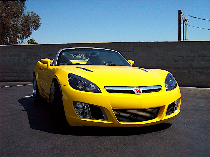

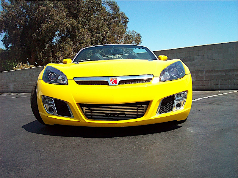

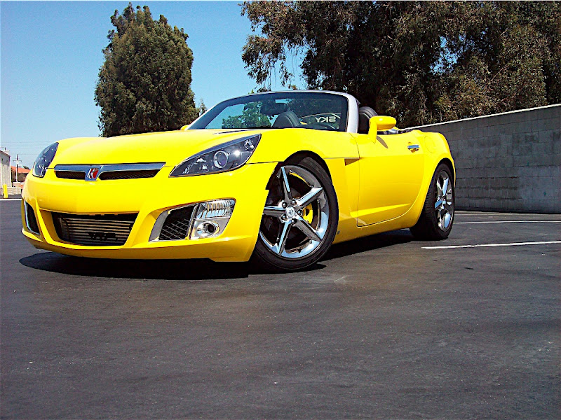

So here's what it looks like
For those of you that are wondering what it looks like on your sky, here it is:
(Of course, my car is lowered)
Also, having driven with the intercooler for a couple days, and having "tested" it a couple times, I can now say it works great. Turbo still spools up quickly, no matter how hard on it I have been all day.
Also, you don't have to remove the front black grill, but come on, you should...
