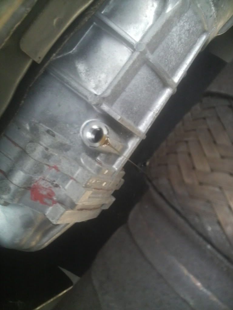

Hi guys, I report you my today`s job.
I changed differential oil last week. Then I changed transmission oil today.
At first I had to remove under floor panel. Driver`s side bolts is OK but passenger side bolts was not able to remove alone.
Remove front muffler pipe from catalyst converter.
Remove drain bolt. I hear like a brow off air sound from transmission drain hole.
I guess that inside of atmospheric transmission case are different atmospheric.
Some guy knows about me, I living in Japan. I ordered this one for GM parts dealer in US. But this gasket was made in Japan. So ridiculous story I imported this parts from US, but this parts export to US from Japan.
I know AR5 export form Japan made by Aishin. It`s cannot be help.
Re-fill plug position was narrow space there. I used plastic pipe.
Then re-fill from engine room.
I found many metal powder in the pan. I decide change oil every 20000 mile.

Great write up and nice photos too.
How much oil did it take to refill the trans?
What type and brand of oil did you use?

<JohnRR
Thanks comment. I selected GM OEM oil P/N89021806 75W-90 G3.
I bought 3 q, The case drink 2.7~2.8q.
I am ex-GM sales, I never used another brand fluid.
If possible I want report you shift feel after change oil, but I cannot drive car yet.
Differential drain plug seal can reuse, but trans drain plug seal cannot reuse.

<Miller11386
A little metal in the pan are pretty common on all transmissions changes.
thanks info. at first, It was some trouble I guess when I sow a pan.
Some time I had miss sift when I hear rasping sound from gear.
Maybe my miss sift made by this metal powder. I must take care when I sift change.

I would make a suggestion here - maybe you can modify the original how-to - ALWAYS check and remove the FILL plug FIRST (BEFORE draining your oil).
Nothing worse than having an empty transmission and a rounded-off fill plug (don't ask me how I know).
