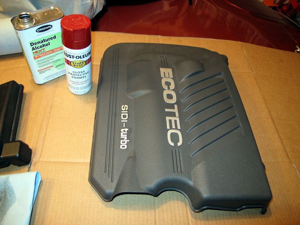

Started a little paint project.
Supplies:

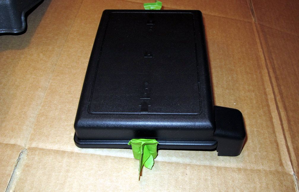

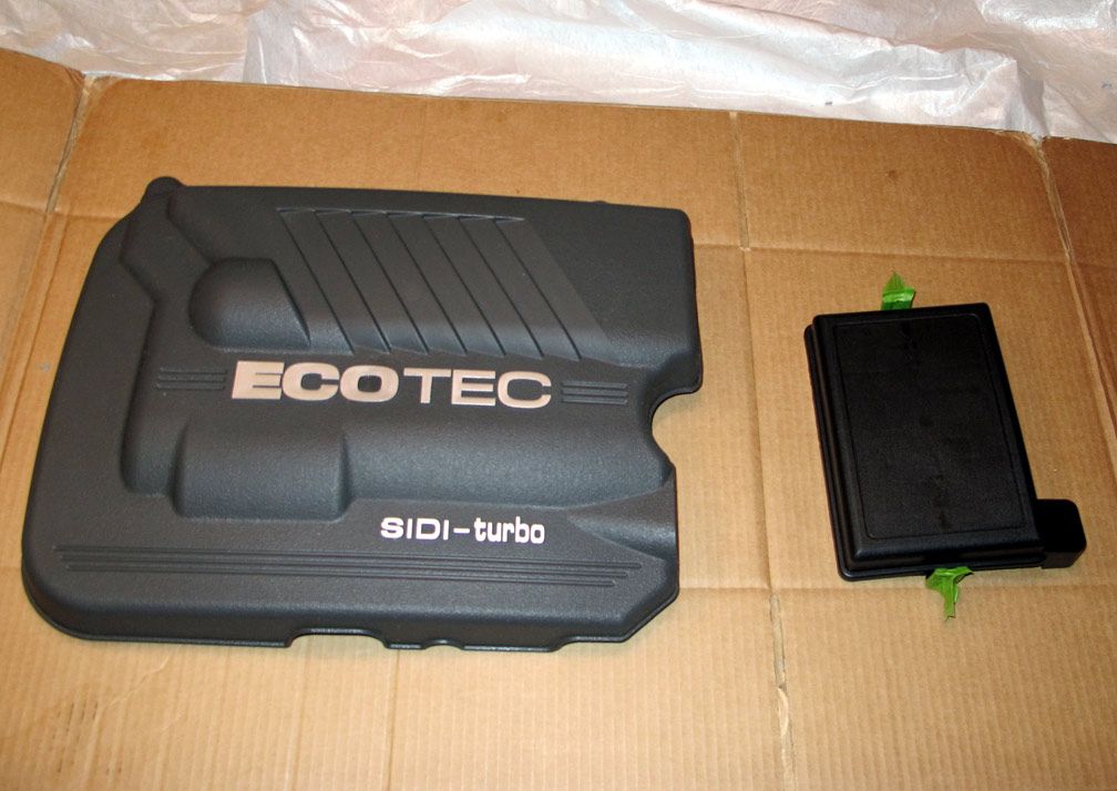

Prepped, cleaned several times with denatured alcohol, then taped.

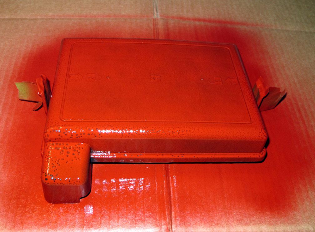

Proof that cleaning means really cleaning:
I had to strip all the paint back off and reclean it several times. It would have been much easier, and less messy, to just clean it right the first time.
After the cleaning and repaint, it looks much better.

Hey Jim why didn't you use the Fusion paint made for plastic? Just curious if there was a reason for it cause I want to paint the same parts myself.
garyv350 is offline
post #34 of 3815 (permalink) Old 01-28-2011, 06:32 PM
Join Date: Nov 2010
Posts: 1,636
Two reasons. I already had this paint, and I have found it to be extremely durable.
