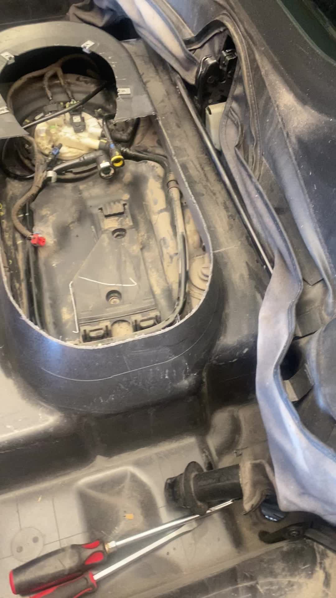

Where I cut the top (notice the slit where the u-nut will go- the other side already has it installed)
The donor top (if you zoom in just below the u-nut, you’ll see a mold line that goes all the way around the temple. This is the guide line I used to cut the donor top at).
Donor top screwed in place.
Grand finale, which sits exactly where the original did.
