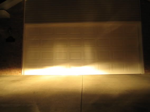

i have already orderd real HID's for the headlights and blue tinted bulbs for the fog lights.
I'm seriously considering an upgrade to HID. When I saw the car after dark, I was really disappointed in the appearance of the stock lamps- way too yellow and dim. They didn't seem congruent with the rest of the design of the car.
thanks alot! from the pics i have seen round here they do look yellowish and dim
