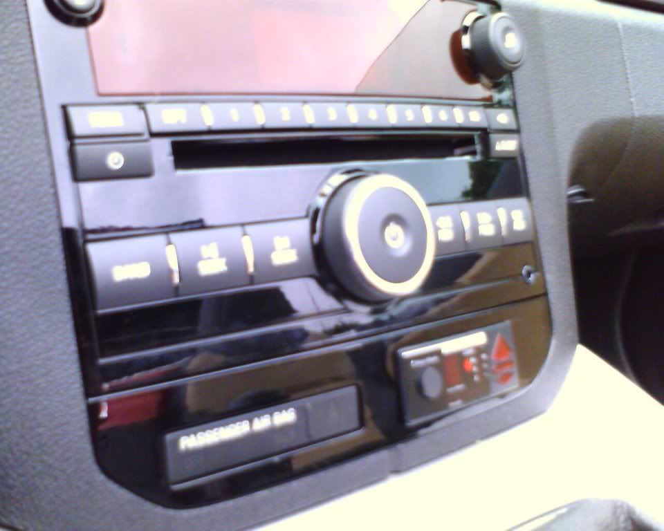

I just finished the install on my car of my Valentine 1. I have the detector mounted above the rear view mirror. I could not get the power to run off anything on the mirror, so I ran behind the trim to the fuse area in the passenger foot well. I hid a componant behind the glovebox that allows for a remote display. The Radar now turns on and off with the car (no door delay like the radio), as I tied it into the HVAC fuse.
I installed a remote display in the dead space area just to the right of the airbag status lights in the dash. There is plenty of room behind there, once I got it off the dash area. This allows me to have status lights, the boguey counter, band warnings etc, not visible to cars (or cops) behind me. The radar is still above the mirror, but it stays blank now. This also allows for me to silence the radar with the mute button on the remote display... which is now right next to where my hand is usually anyhow, on the gearshift (manual).
I was getting creative, so I also ran another microswitch mute button into the transmission hump and into the shifter boot itself. Now I can silence it without even moving my hand off the shifter... it is beneath the leather, just a couple inches below the chrome nob.
Here are some (bad) cell phone photos of the display install.
Yes it was scary cutting into the plastic part of the dash (with a dremel). I measured it over and over, checked for clearance of the tabs to the part, etc. Finally I did it, and it came out pretty nice, if I must say so myself (and I must). It is pretty flush, no exposed wires, and most people think it was always there. :) I dont know how much that trim piece is, but I wrote down the part number (before I cut it off) in case I need to replace it someday. :thumbs:
If you want to take off this trim piece you do NOT have to pull off all the surrounding areas of the dash. It is held by 4 little clips in the plastic... I found this out after I had taken everything off. I fished the wires back through the dash with a hanger, and that seems to work fine. The ABS light display just clips into this part, so it is easy to remove too. :thumbs:
I just had to share, it is the first time I have done something like this without someone else having done it first. I already did the garage door mod with a button in the bottom of the dash, but this had the potential to really screw up the car. I was so proud of myself I dragged the wife out to look at my handiwork... she just nods and give me the "that's nice dear" line. She just does not appreciate this car as much as I do! Or maybe I am just too immature... hmmm

Very nice set-up. Can you get a pic of the radar, too. I know it's tough to be the first one to do something...

Very nice!!! How much space is behind that spot? I was thinking I might try to add a door lock/unlock button there.

Ok, the rain stopped long enough for me to take some photos. Again, I apologize for the poor quality of the cell phone camera. The first is just the radar detector above the mirror, as seen from the driver's seat.
This next photo shows the bracket which holds the valentine, and the wire hanging down. You cannot really see the detector at all from outside of the car, so I had to take them from inside. You can see that the wire length I left is just enough to reach the detector. I go behind the trim pretty much where the onstar wires go in.
another of the detector in place, more from the passenger side, so you can see the wire.
There is PLENTY of room behind the panel in the dash, directly below the radio. The panel pops off (4 clips) and you can slide a whole turkey sandwich in there if you felt so inclined. There is a small piece of silver plastic that sticks up a small bit on the right (the left side has the airbag lights). I cannot see a real purpose for it, and I was prepared to trim it down if it interfered with the install of the remote display. It did not, so I left it alone. I wish I had taken a picture of the opening when I had the panel off. The airbag light cluster is attached to a wire harness with enough room to hang the panel out from the dash a bit after you pulled the panel, or you can simply unplug it (which I did). I used a dremel with a high speed bit to cut out the hole for the display unit. I intended to use a polishing bit to clean it up, but the display ended up covering up any irregularities in my cutting. The display fit in from the front tightly, it will not come out really very easily. It cannot be pushed in from the front, that's for sure. I put painters tape on the front and back of the ABS plastic panel when cutting it, thinking it might protect the plastic from scratching and such. I have no idea if it helped, but it did not hurt, and it gave me a surface to draw my template on. I started doing the trimming at the kitchen table. Don't do this. Millions of tiny pieces of black plastic go everywhere. My wife found it less than amusing. Also wear eye protection. I ended up finishing up outside, and had to take a shower after. I am sure there is a better way to make nice straight cuts, but I dont know what it is. My dremel instruction manual also recommends cutting plastic at a SLOWER speed as it can melt the plastic if too fast. My dremel, however, is only one speed, so I just did it anyhow. I cut from behind, and the little melt I did see did not seem to affect the front of the panel at all. Was I just lucky?
It is good to make the hole smaller and enlarge just as needed. If you want to do this project, PM me about the remote display. I used a modified one, not the one from Valentine themselves. I think the one from them will work fine (its deeper), but the modified one is pretty trick, and the remote mute switch is kinda cool too.
