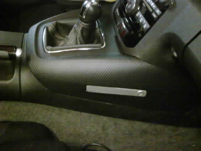

479 Posts
I keep the dark interior theme and applied vinyl carbon fiber from ebay. It's vinyl and with spray on adhesive stretches to the shifter console well. $20 for two feet length.
479 Posts
Mike, can't find the link but it's fabric back vinyl with CF look.
